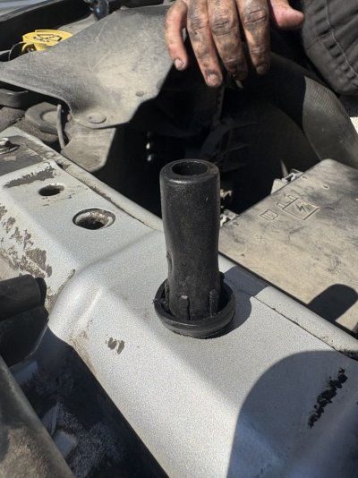

New problem today - this broke .. correct me if I’m wrong but that’s the boot I now need to replace right ? IMG_1689.jpeg

Spark plug boot, yes.
