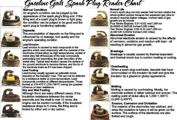

You can learn a lot from spark plugs.
Check you plugs against this chart.

This chart should be a sticky or maybe in the DYI section
