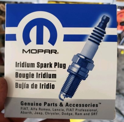

I also just did my 100,000 mile spark plug job. I splurged for the Mopar plugs, and I noticed an interesting instruction on the back of the box for tightening the plugs: they recommend finger tightening until firm contact, and then turning another 1/2 to 2/3 turn with a ratchet. This has the interesting effect of applying the same amount of twist, and therefore "stretch" of the plug whether it has anti-seize or not, since you're not relying on applied torque, but instead measured thread twist/pitch/stretch.
I had all the right bank plugs installed this way with a 1/2 turn (I happened to not use anti-seize on most of them except for cylinder 8 because those were buggers to put a wrench on and I didn't want problems at 200,000 miles), and only then did I start to worry I had done wrong by not confirming a torque value.
So I looked up the torque values for the iridium plugs and found 18.5-22 ft-lbs, so I figured 20 ft-lb would do it. I put a torque wrench set to 20 ft-lb on one of the cylinder 2 plugs and started to crank, and to my relief, it started to turn without clicking. That meant I hadn't over-torqued them using the 1/2 to 2/3 turn method. As that was what was on the box, I figured it was just as valid of a method. And if you happen to use anti-seize and are worried about torque reduction, this method side-steps that problem. It also side-steps the problem of not being able to fit a torque wrench in those hard-to-get rear plugs.
