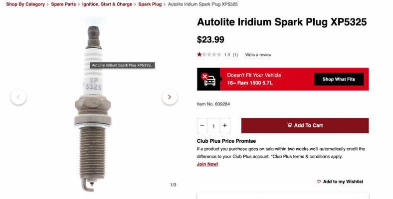

So I tried to order these from one of our suppliers over here who states "They will not fit a 2018 Laramie"
Can you confirm that they will 100% fit?
See below

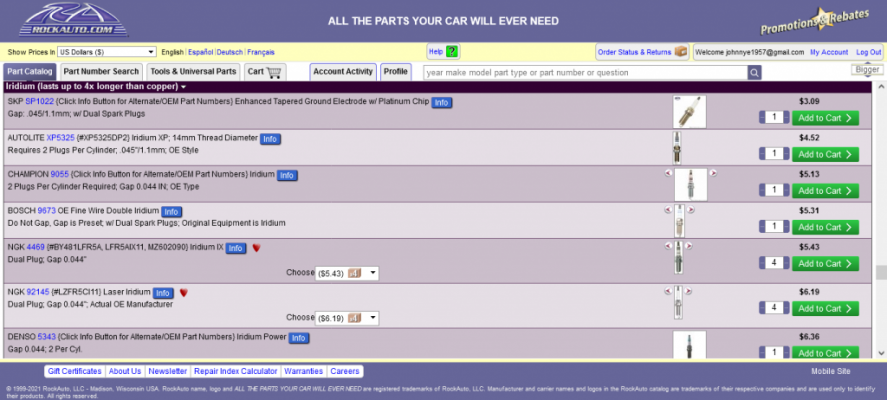

Take your pick in the Iridium section.........all these work......most use NGK92145
Screenshot 2021-12-01 at 08-20-05 2014 RAM 1500 5 7L V8 Spark Plug RockAuto.png

Take your pick in the Iridium section.........all these work......most use NGK4469
Like he said, altho I would say most use the NGK 92145, that's what i have in my 2014. And definitely get that GearWrench 80546 it is a lifesaver!
Thanks for catching the wrong number.......I corrected
