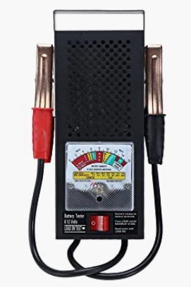

If you're continuing to experience multiple electrical system anomalies, I would backup to the beginning and start with load testing the battery and then verifying all common grounds.
The electronics in our trucks are very sensitive to either one of those conditions being only slightly subpar.
Most auto parts stores will test your battery at no charge. Ideally, make sure they use a toaster type load tester because the results are much more reliable. You might consider buying your own because they're only about $20 from HarbourFreight and a great tool to own. I have 2 of them.
Amazing deals on this 100 Amp 6/12V Battery Load Tester at Harbor Freight. Quality tools & low prices.
www.harborfreight.com
