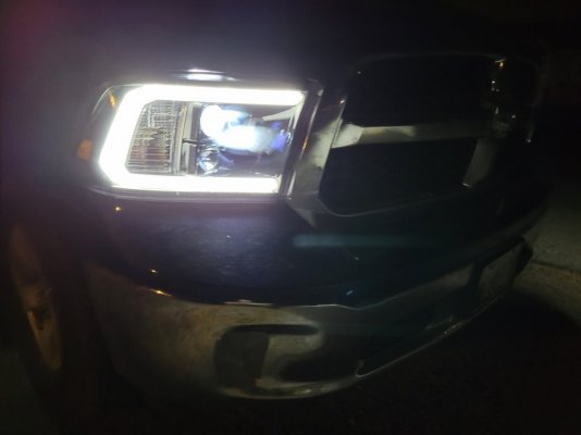

Not sure which spyder headlight you're referring to. I have a pair of light bar ones, they take an H1 bulb instead of the stock bulb.
As far as lighting quality is concerned, i like them, but am also still in the process of getting them properly aligned. Works been too busy to be able to bother with them much, adjustment screws are a PITA to get to
