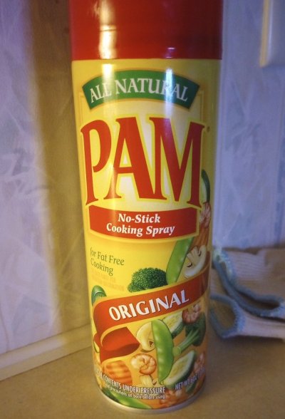

I use PAM, the non-stick cooking spray, lol ... for me, it permanently solves the squeaky door issue.
