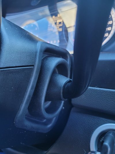

I found this thread a couple of weeks ago while trying to find the replacement boot for my 2014 1500. For whatever reason 2014 only shows up by ordering the whole shifter. The boot (68400287AA) for everything else looked the same and I found one on Amazon for 16 bucks. This part does in fact fit a 2014 1500. The only thing I messed up was I stretched it over the knob instead of taking the shifter apart. It split the collar a little. For 16 bucks I will probably order another one and install it the right way lol.

It does not look to terrible of a job , but I put it off ,then forgot about it .
Now that this post showed up , I suppose it is time to get er done.
