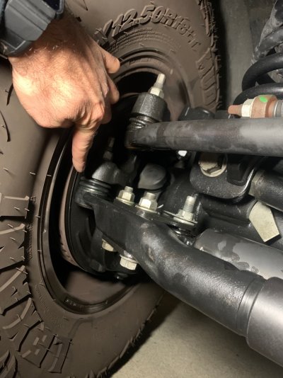

Squeak gone! I injected lube using my son’s insulin syringe into the tie rod ball joint. So far no leak, can’t even see the hole. Fixed for the time being until I get new joints.
want to replace both sides with heavy duty ball joints instead of oem.
Anyone know the exact part name for it? It’s this ball joint.
