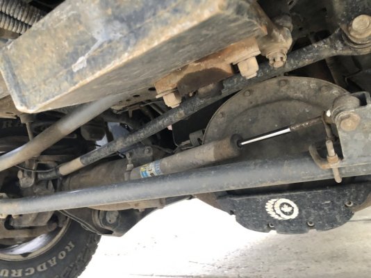

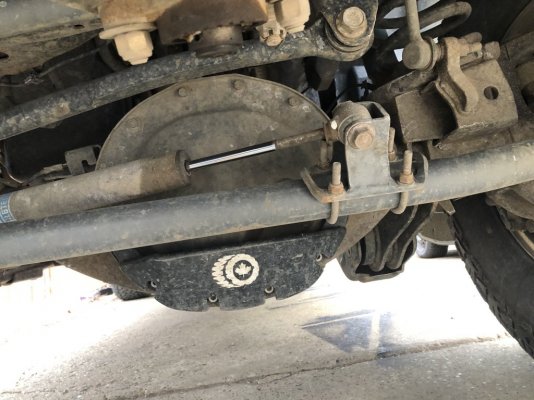

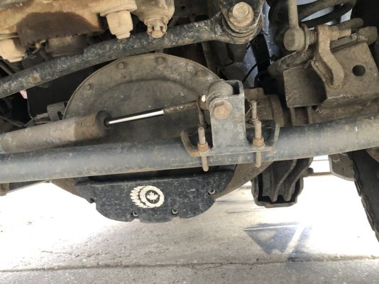

I run a bilstien on a synergy steering correction drag link the bilstien bracket didn’t fit because the drag link is bigger in diameter so I used the stock one with bigger u bolts

I had to grind the the sleeve in the new stabilizer about a sixteenth of an inch I hate modifying new parts lol
