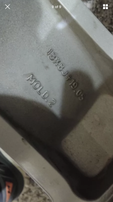

Haven't been able to find it online. Does anyone know the offset and backspacing specs on the stock 18" rim for 2019 Ram? I'm trying to compare with some new wheel options to see where they would fit.

They are 18x8 with +19mm offset which calculates to 5.25” backspace
