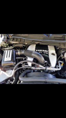

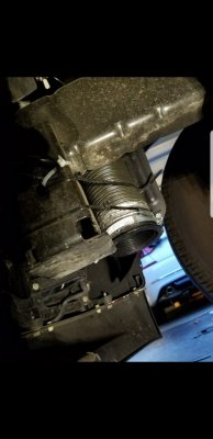

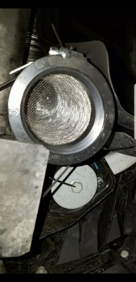

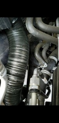

Or just put in a good(I used AEM) filter then add a 3" tube from bottom of airbox to behind bumper. I ran that for a while, flows good and seemed to pull a bit harder/longer. Added a screen to keep the rifraf out.
All told 30-40 dollars and some creative home depot shopping

You can see it in this pic
