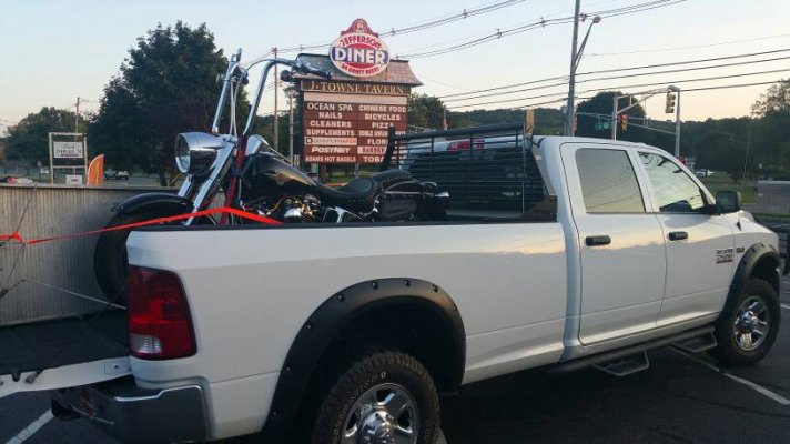

I'm thinking about Plasti-dipping my chrome bumpers, grill, body below the crease and stock wheels. Well, more than thinking...I bought the 12 cans I estimated I needed. Soon as I get back to TN. Had to pick up my scooter in PA. dedfb097694150053746c2d00e748946.jpg

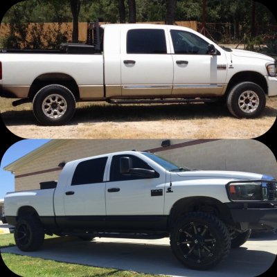

I did that on an older truck, few key points to make it look good.
1) make sure it’s absolutely clean and dry!
2) start with a light coat for the first 2 or 3
3) do at least 7 rounds...it will stick better, look cleaner, last longer....and if you ever want to pull it off it will actually come off in large pieces instead of small chunks.
4) use painters tape to get your lines straight.
