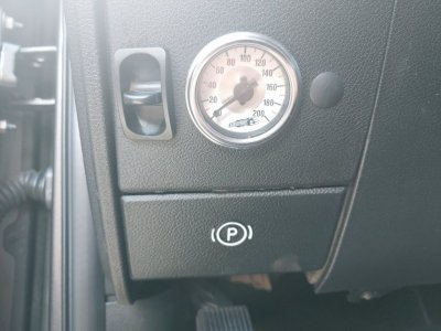

I could use your guys' experience and knowledge to help me track down the purpose and usefullness of some kind of gauge in my dashboard that is clearly something aftermarket from the last owner.
I'll crawl under where you guys tell me to to figure out where this gauge goes to and what its for. On the up down switch, pushing it down makes a slight noise like air being released, but moving it up does nothing. At no time does that gauge go up or down if I move that lever switch.

Could be anything. Does the number change when you crank/drive or change when accelerating/ operating temp? If it doesn’t change no matter what happens, could be for onboard air that previous owner installed and took off before trading in.

It does looks like a gauge for an onboad air tank. They may have removed the system and left the switch and gauge to avoid having holes in the dash when they sold it.

DITTO: Looks like aftermarket air gauge/pressure gauge ref Air, Maybe previous owner had like Airbags in the back ref towing and height adjustment, that would be my thought. The bags that go in the springs.

You’ve got an EasyStreet air gauge there for an onboard air system. I’d bet like others have said, the system was removed and stock parts replaced before selling.

I think sir that you may be right. It was clearly a long haul / work kind of truck. They put about 24000 miles year on it. That gauge range makes me think you are right.

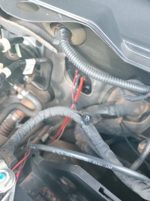

Ok. I think after crawling around underneath, you guys more knowledgable than I can close the gap. Mind that I embarrasingly have a CDL and should know this stuff better, but the way big rigs do air brakes and the whole braking system is far more simple that the kind of "civilian" style systems you'd create for a Dodge Ram pickup vs a Tractor Trailer puller. I'll show the pictures below, but I would bet, based on the miles they put on this truck every year (25k'ish), they were pulling some kind of trailer with air brakes, and they used a compressor to keep the brakes open on the trailer.
This is where it came out from inside the cabin...i followed the line underneath to the next pictured item:
Clearly an air tank, the next picture proves its for compressed air:
Obviously the compressor motor.
I followed this line, which came to the back bumper...
The air comes out here. Not sure if they would actually connect this to an air brake system on a trailer, or they thought it was useful somehow to fill some other tanks or tires? Not sure. My guess is stil some kind of connection to a trailer air brake system, but I could just as easily be grasping for answers.
Either way, the thing doesn't seem to work, so I will eventually try to think of some way to get it working and use it somehow, or remove all the items.
Guess I'll just have to ignore there is a weird gauge in my dash and lie to people that its NOS or something...lol...

You have on board air and compressor setup. Really nothing more than that. You probably have air bags in the coils or air assist springs somewhere.
Doesn't look like there is an air hook for trailer brakes on your setup.
Edit: It looks like they might have disconnected your compressor.

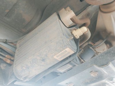

Any idea what this thing is? This is some kind of stock Dodge Ram part I'm just not familair with:
I don't know on that there.
It's a vapor canister for venting the gas tank.
