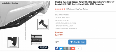

My brother installed a set of the Oedro 4" running boards as pictured above on his 2019 classic. They look nice, fit nice and no noticeable flex, although the kit was missing one bolt which was frustrating. He also managed to strip out one of the pressed in nuts in a step because he was then in a hurry with his cordless impact. LOL. Not sure how he fixed that.
I don't care for the mounting system on the truck at all though, with the thin metal in the rocker panel, the use of nut/bolt plates, etc, but that's the way it is with lots of today's pickups. You're smashing dissimilar metals together. It's going to grind together, flex/move/wear and rust over time in rust belt use no matter what you do.
