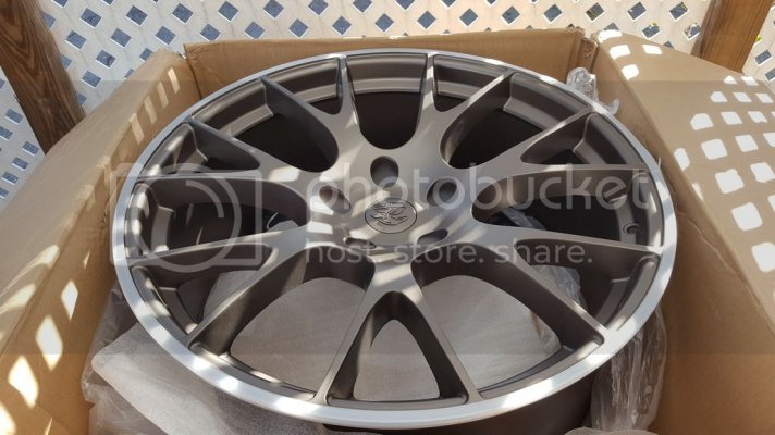

Ok Parts ordered
22x10 Hellcat wheels
305/40-22 Nankang Tires
Groundforce 9983 lowering kit
All going on 2017 Ram 1500 4wd Regular Cab short bed

Wheel & Tires go on this weekend. I will upload pics.

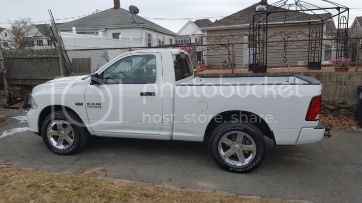

wanted to post this up as there never seems to be enough photos of us all using our lowered half tons to tow.
Finally took a photo of my rig all loaded up.
Love that this thing still tows with the GF 2/3 kit. (35psi in the helper bags)
*Missing from this pic is the wife's dirt bike.
