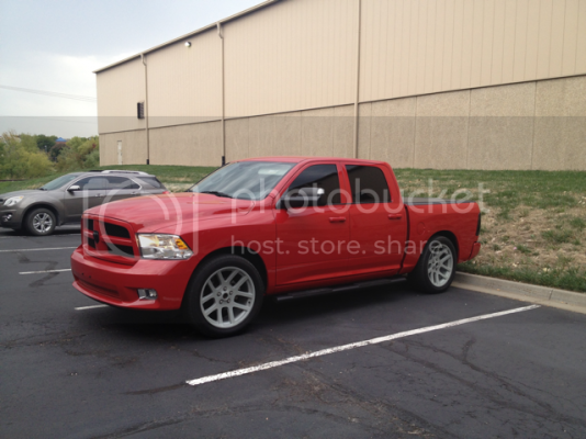

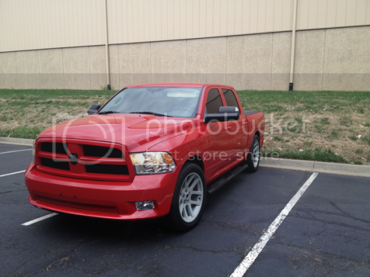

Here's a couple pics of mine with the ground force 2/3 kit.
Just got wheels redone black haven't even got them back on yet
Man I have to know what wheels you're running? That's the exact ones I've been looking for. Could you give me the size and specs on them? They look great.
