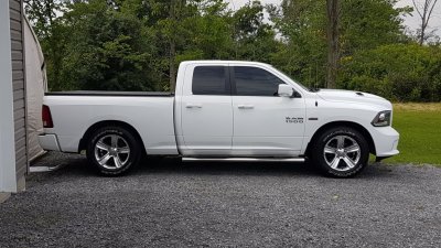

I've done a 2/4 with mine using the GF front coils and Belltech rears.. But I found once I put the airlift's in that only with 4-5psi in the bags it doesn't lift the truck enough to notice but it definitely cushions the blow on rough roads. I live in the country so I needed a 4x4 truck and wanted it lowered. It bottoms out on a few key area's enroute to my house, so I needed the airlifts. I've also towed 8k with it and had 800lbs in the box... They work as they should. I've considered the illicit no cut brackets, or the entire Inez 4-6 drop because I find I want more lowered!! However the 2019's are also in my wheelhouse... So I have to decide which way to go..
With a 4" rear drop get airlift 1000 kit..
With a 4" rear coil drop are you guys hitting the bump stops on rough roads/bumps? Did everyone cut them down or do you guys not hit them?

Nice looking truck. I too want more low. Thought about the BT 4" coils too.
What airlift kit do you run? Durrango or Ram 1500?
Any side shots of the truck? Curious on rear wheel gap?
@DwnDak 1st off your truck looks amazing!! I have an 18 QC Sport and that is the exact stance that I want to achieve with my truck. I have a couple quick questions, What was your reasoning behind using GF coils up front but Belltech coils in the rear? Are you still using the factory struts and shocks? Did you purchase your GF coils directly from GF, I cant seem to find anyone selling just the fronts. Lastly did you use the standard AirLift 1000 kit or the HD version?

The belltech website does not specify. But looking at the kit the front drop is achieved via the springs so I would assume adding 2WD spindles would just give you another 1" like you have gotten with the GF kit.
Thanks! I'm happy with it until the 19'***** 0% then I'll probably sell it, but it rides well. The reason I went with GF/Belltech combo was the simple fact that the GF doesn't offer a 4" rear drop. I know a lot of people just cut a ring or two off their GF coils to achieve this, but I prefer buying what I need when possible rather than modifying. Belltech offers the 4" rear spring so I bought it, and contacted GF directly to order the front springs only. For some reason GF won't separate the 2/4 kits so I got the part number online somewhere, and called them to say my truck had been in an accident and I needed 1 spring, but would order the pair to keep them together. They shipped them out and in 2 days I had them.
I'm just running stock struts/shocks for now and the standard AL1000 bags but because they are so stuffed into the coil, one rubbed through. I am going to either leave them for when I trade in the spring, or order HD ones if I keep this truck beyond April/May.
