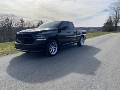

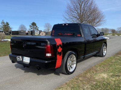

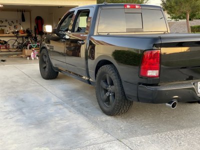

2nd for the belltech 2/4. Part number is 965sp for the 4x4 kit. Here's my 2017 4x4ce645909f3197f1c07e0a2c54d0b7cbd.jpg46d03ccc5e96da6fa74a99c8e6b6f26f.jpg

I wouldn't think there would be any issues with stock wheels/tires, but I can't speak from experience. I haven't had any alignment issues on mine. Got it done about 3 months ago.

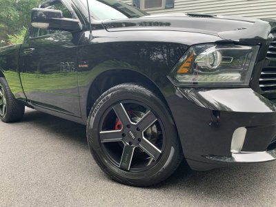

Anytime you change geometry on your truck you will need an alignment. Depending on how far your local shop is, you can install the kit in your garage and drive it to get aligned. After the alignment, you shouldn’t have any problems. At least I haven’t.
I’m still driving factory 20s and original tires on mine. No problems:

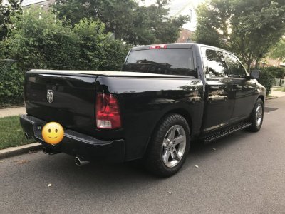

nitto grapplers, 275/60/20s, they come with the truck when i bought it.
