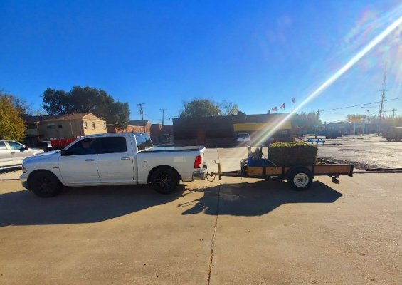

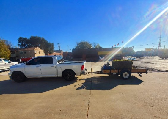

What did you do with the pan hard bar and what size tires are you running also how about posting up some pictures of your ride
I assume you're talking to me....
I have a "Cutter Up" pan hard bar. Its a local performance shop that made a small batch of pan hard bars. Got this one after I ruined a Spoon one. Buy a Core 4x4 one if you can. They are better.
Check this out- https://www.ramforum.com/threads/adjustable-panhard-bar-spohn-vs-core.126098/
I have run a set of 305/45/22 but am now on 275/50/22. Run 275/60/20 in the winter.
The 305's rubbed very little at full lock. Would run that size again.
Apologies if the picture doesn't show up. This is a photo of my truck from the previous page while hooked up to our trailer.
Typically I also have 2 dirt bikes in the back of the truck also.
