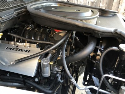

I just replaced my waterpump but I had already deleted my fan clutch and I run a V6 E-fan. In order to get that fan clutch off, it actually extracts clockwise, not counterclockwise. Lots of youtubers show the use of hitting a big crescrent wrench with a hammer while using a flat bar with 2 bolts drilled and inserted in the waterpump pulley. I went a different route and it was SUPER easy. I climbed under the truck, using the tool from Autozone, and a big crescent, was able to muscle it off. I got rid of the fan shroud, etc and have a TON of space now on the engine to work on things (like replacing the waterpump I did a couple weeks ago).
Good luck!

I dont know how you guys get anything else done with how clean your trucks are!
