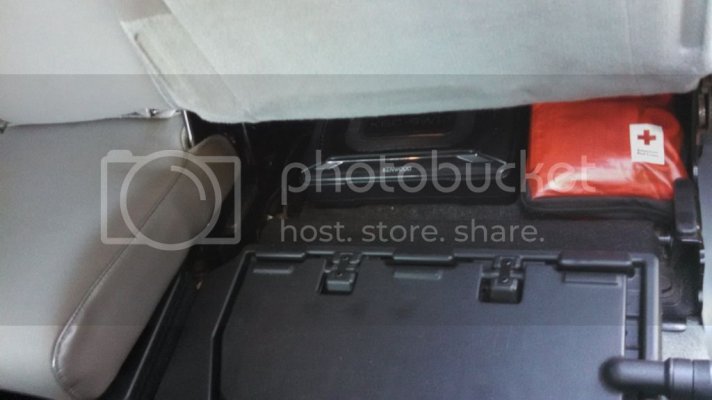

Is the backseat storage removable, like with some sort of fabrication? I don't use it and can put all my stuff in a bed tool box. IMG_1012.JPGI need to fit these puppies in.

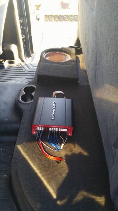

I completely forgot to post my results!
I did end up fitting a box under the passenger seat. The box is 0.35ish cubic feet sealed, and works nicely with the 8 inch sub I put in it.
The box ended up hanging back into the rear foot area more then most would like, and it can probably be shorter, but oh well.
I also had to cut the carpet and relocate the wire harness in the front most area under the seat. Otherwise it would not sit level on the floor. It's not visible though.
The seat is now limited in movement as well. It can go back all the way, and about 5-6 inches forward.
The seat adjuster had to go, and I made a mess of bending up the original one, so I'll have to make a custom one for it, but it can still go in and work.
I also had to take A LOT out of the seat brackets with a Sawzall. It is way weaker for side forces, but should hold up to abuse with normal sized passengers. It can't go far before it hits the door or the middle seat if it does bend anyway.
Looking back on it, I should have used 1/2 mdf instead of 3/4, but oh well. It's definitely worth It, a couple weeks after getting it in there, I fit 5 people in the truck, which wasn't possible before.
