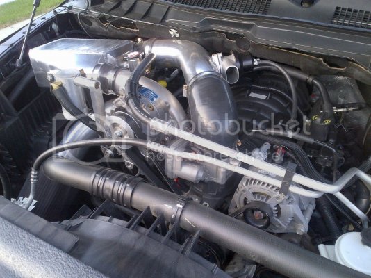

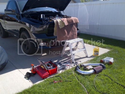

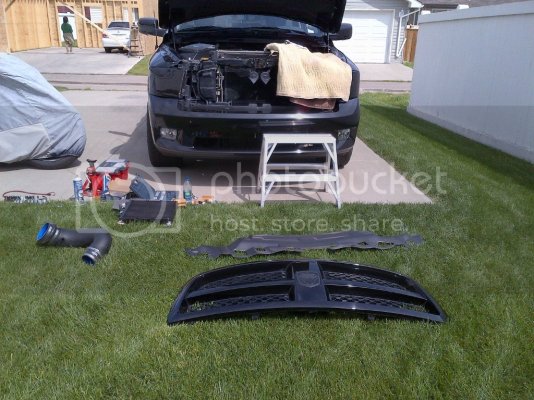

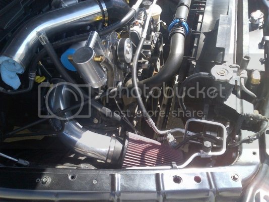

0-60mph? oh I can relate to that, but you'll need traction
10' Hemi RCSB Sport 4x4 3.55's
heavy-ass 305/50R20 Terra Grappler's on stock 20's (street set)
AWD launch (4-Auto) = no spinning
Mod's:
Ground Force 2/3 drop, Fastman 85mm TB, JBA Shorties, BT Catch Can
Maggy CatBack and Y-pipe, Diablo Trinity, Jet 180º T-stat, TYC E-Fan
...oh ya
and a Ripp Supercharger 8psi kit (aprox 500whp)
Edge 2800 Torque Converter that flashes at 3300rpm now.
Still working on the tune, cant raise shift points over stock (5600) or it leans out too much
Aeromotive Stealth 340 fuel pump, water/**** kit and L&M Customs transmission to be installed
before I can put on my 28" Drag Radials/lightweight 17's (all four corners) and head back to the track.
(effective gear ratio 4.30:1)
FWIW, best NA track times were 13.89/98.5 at 2500' DA (13.4/102 corrected)
I hope to run 12's soon
Make sure you budget at least $3k for a "built" transmission!
The best part of the Ripp kit is you can DIY driveway install with basic hand tools on a weekend.
My CMR tuner wont dyno mine until I install the upgraded fuel pump he got me,
...but here's my track Bud's run (same truck/mods but a quad cab 4x4)
(run stopped just short of 500hp even though it was still climbing due to stock fuel pump running out of juice after 5600 rpm)
That's 200whp over stock, we paid about $4k for our kits
