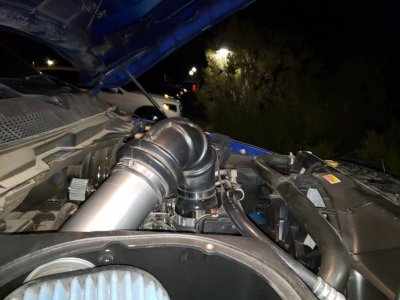

With no disrespect to Moes at all, that’s not what I’m about. His isn’t a true bore TB. Check out fastmans site and you’ll see his work and how he has specific true bore throttle bodies of different sizes depending on how much you’ve modded your truck
Hellcat TB :evillol:20190608_210347.jpg
