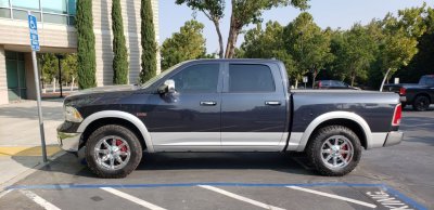

I used Supreme Suspension links on '17 1500 and they worked perfectly and the quality & price was great. When using links you have to shorten them in small increments, too much and you screw it up. I believe I shortened roughly 3/4" to get almost level. I say "roughly" because each side was different. You have to shorten, cycle and then measure. Repeat until even both sides. If you lift too much you'll lose your Aero mode or OR2. Pic for reference
