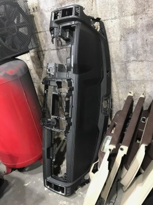

slowly i managed to swap most of my interior from express to laramie. now im looking for top dash panel. my current one is plastic and one from laramie or sport would really set it off. the stiches etc :).
does anyone know the part #? i've been searching but nothing yet. i attached a pic for reference.
thanks in advance

That piece is one whole unit. You essentially have to take everything off and it's basically the whole under part and all your interior relating to your dash mounts to it

Also can you snap a pic of the part number?
Part# 5MY12LT5AA for the dark charcoal leather In color, according to my dealer. Cost on it is around $575 new.
I am going to attempt to change it, assuming it will take a full day maybe more

Godspeed. In all seriousness how is the top attached ? Glue? I found this pic but can't see anything.

It’s honestly not that hard at all, I’ve done it twice...best thing to do is to pick up the dash you want at a junk yard (Sport, Laramie, etc for the stitching). This way you don’t have to swap out the wiring, air ducts, etc. From there it’s just unscrewing the 3 bolts on each side, 2 on top, a few once you get the steering column out of the way, then the connections to the wiring on the dash.
The dash then just comes out with a simple lift and pull..best done by 2 people. At worst, should take 1/2 day for someone who is somewhat mechanically inclined.
