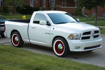

There's a sonoma in my area with 16" steel wheels painted body colour with chrome rings and centre caps and white walls. If i see it again I'll take a pic. Very hot rod looking and I like it. This is a similar idea on a ram.3843117155_3a33cccecc_o.jpg

^ that is not my thing but I think it is cool looking!

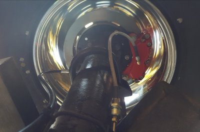

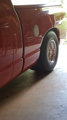

First off IMO build your truck (hot rod) to suit yourself. If it's, so much the better as long as you are happy with it. I built the rear on my truck to fit the wheels. Still working on what I'll do with the front. Having a hard time finding an appealing wheel thats 30" tall.20180726_154355.jpg

First off IMO build your truck (hot rod) to suit yourself. If it's, so much the better as long as you are happy with it. I built the rear on my truck to fit the wheels. Still working on what I'll do with the front. Having a hard time finding an appealing wheel thats 30" tall.View attachment 153552
Now that's what I'm talking about....that setup works!!
Can you give me your details? sizes?

Used the 9.25 axle. Cut the tubes replacing the bearing collars with ford torino collars. This allow the C clips to be removed and brake kit for the ford to be used. In this case Wilwood brake kit with hidden ebrake. These connected up to the trucks parking brake cable nicely. Being small diameter, 15" rims easily fit. Used strange custom axles with 5x5 bolt pattern. These are basically ford axle cut to length. In my case 61" flg to flg. To maximize clearance the bed needs the wheel tubs moved in 4" to be even with the frame rails. I use weld wheels 15x15 with MS S/R 31x18-15 tires.
