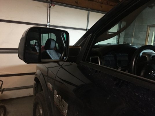

So. Swapped my power folding mirrors for the new trailer mirrors. I know you guys like the power folding. I pull 30’ Boat. Its a Necessity ..was VERY easy! 90 min both sides!

Nice. Where did you get them from? Step-son has a 2019 1500 new style and wants tow mirrors. I know for the 2018 you cannot get them from the dealer and 1A didn't have them for the new body style yet.

I will Get info Monday. Its at work. Trust me when ai tell you I shopped to find cheapest, with cheapest shipping! FYI they are Mopar not aftermarket.

Is there no power fold option for the tow mirrors, I've been looking too but have found new body power fold tow mirror have them on my 4th Gen and really like them for towing and the ability to fold them in in tight places

1A Auto sells the Trail Ridge power folding tow mirrors but not sure if they have them for the new body. Me and my son both bought them for our 2018's and they are great. Power fold works perfect.

Well, we all have different needs. I can see times where I would have benefited from having tow mirrors. But I use the power folding feature everywhere, so I'm keeping them. Appreciate the info and pics though. BTW...what wheels are those?
