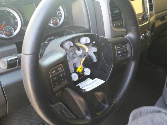

Unfortunately the compass will not work when you install the 5.0 RA2 radio on your truck. The radio gets the compass heading from the module in the overhead console which your truck does not have. In the 13 to 16 rams the conversion is easy to do because the microphones are actually in the rear view mirror. All you need is the mirror,mirror harness,the hands free button installed in your steering wheel and of corse the radio. In 2017 Ram moved the microphones into the headliner. If you installed the radio without the hands free button installed in the steering wheel there is no way for you to communicate with the radio. Not sure if you installed that or not but thought I would mention it. You don't need to add any wiring to install the hands free button. You just need to pull the steering wheel and install the button. You can also install the steering wheel audio controls in the back if you chose at that time. If you check the DIY section you will find writeups on all of this. The only thing I'm not sure about on your truck would be the microphone. I am not sure if you could just change the mirror harness and install the microphone mirror like the 13 to 16 Rams or if you would need to do it a different way. You can purchase RA2 radios on ebay or car-part.com extremely cheap. Also a lot of people on the forum may have an old RA2 laying around they may want to sell. Make sure the RA2 you purchase is out of a Ram. In the past people have had issues with the balance and fade not working when the radio came out if a different vehicle. If it were me I would buy the radio and install the hands free button in the steering wheel. The mirror harness for the 13 to 16 rams is only around 20.00. You can buy the RA2 microphone mirror on Car-part for around 50.00. I would try that combination first and see if it works. On the 13 to 16 rams you can convert the backup camera from the rear view mirror to the radio. I belive M2 Mods a vendor on the forum may make a harness to do it. You can find them in the vendor section and send them a PM. In other words I think it can be done you will just need to figure it out. I inserted a picture of the hands free button on my truck. It's the button on the left side. You can see the two extra buttons on the top of the switch. Sorry this is a little long winded just trying to give you a quick explanation to point you in the right direction. fe5da6363f694a54e8347eb62896ab48.jpg
