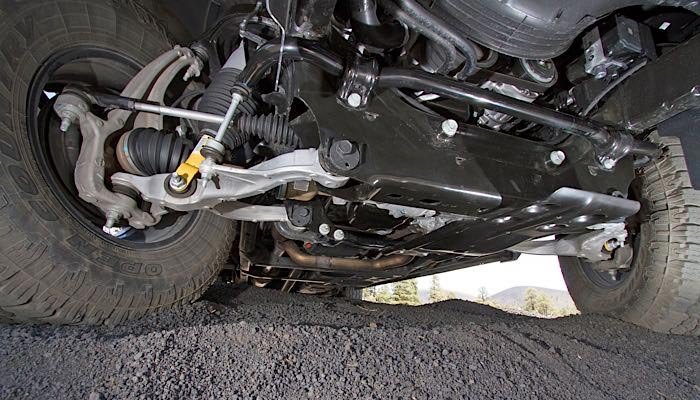

Guess it depends on which end you are talking about? the rear sway bars look very similar, and should be interchangeable between 1500 and 2500.
However, the front sway bars my have just enough differences to prevent swapping.
1500,
2500,
On the 1500, the mounts are on the front of the cross member, and appear to be inboard of the frame a bit. While on the 2500, the mounts bolt directly to the under side of the frame. The bars also appear to have a slightly different shape to them as well.
