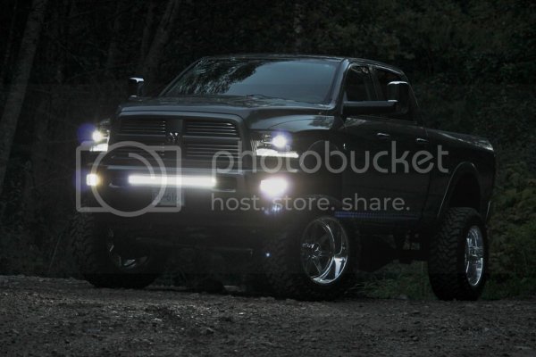

^^ Agreed. I have Morimoto 5000K HID's from Jeremy and a set of built 13+ projectors with the switchback boards and the HID's in the projector match the LED's perfectly. The HID's I have in my fog lights (Morimoto 5000K as well) appear slightly more yellow, but not by much.
The pictures I have are not the best quality because of the brightness of the lights. But here's a shot with all my forward facing lights on to show you how well they do all match.
