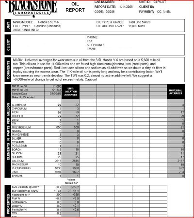

What determines your oil change interval is tbn, total base number. When you run low on TBN the TAN or total acid number raises. You really should invest in a single UOA from blackstone towards the end of an interval. So at the 10 month mark with somewhere around 10k miles, send your sample in. M1 costco deal is pretty cheap like 4 bucks something per qrt, I would lean towards doing that twice a year as opposed to annual protection, just an opinion.

There are plenty examples of oil not making 10k miles. It doesn't matter the oil, even redline can fail under right conditions, and redline has always been a long interval oil. There is a lot that can happen, oils constantly change, and the newest oils are the worst at tbn with the lower calcium levels. With fuels being what they are, that is another potential issue with tbn failing. Now, I have had redline uoa's that show 3 plus tbn after 10k miles, but this guy at 11k miles was way out of tbn and probably was out for a while. Like I said, no matter what oil you use, if you plan on 10k intervals then get a UAO with tbn or you are at risk.

All you need to know, the uoa I posted was a guy that did short trips, he simply ran out of tbn. If all your driving is 10k FREEWAY miles, I would generally say yes your oil will survive that for 10k miles. If you do short trips, an 8k mile interval would be advisable. The problem is TAN, when it increases it ******* eats your metal. That is why that guy with a Honda had such high wear numbers, more like a Ram then a Honda. It has less to do with oil then how the truck was run and it's enthronement. Why not test yourself if you dont believe me. You try that 15k mile oil and do a uoa at 15k miles, report that back to syn thread, I would love to be wrong.

lol, ok partner, no anger was involved. Just a stern warning against TAN build up as I showed. Get this one through your head, TAN is acid, it is what determines a safe OCI. If you go over this because m1 told you to go 15k and you believed them, then you are a darwin award winner, with respect. Carry on.
One More for ya.
Optimizing Drain Intervals Using TBN vs. TAN
