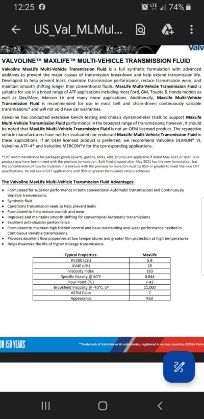

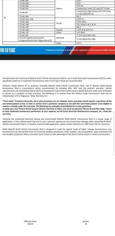

I read the label in YOUR photos. It showed equivalency between that oil you bought and Mercon5 among others. All the current fluids are synthetic. Anti shudder, anti foaming, among other additives are the distinguishing aspects of a particular fluid application to a manufacturer's guidelines.. If you are wanting to be diligent, why not buy genuine Mopar fluid emblazoned with that particular registered trademark? Just asking! Peace!
recommended for does not mean equivalency. a mercon v spec oil, well its intended to go in fords. their mandate ends there. maxlife was designed to go into many makes, and i believe its a superior oil to just merc v or dex vi et cetra.
a few years ago when i was working in a light duty garage we bought maxlife by the 55 gallon drum and put it in everything that was "recommended for" on the spec sheet, and the bosses whole fleet of dodges, and it was always a great oil, no comebacks.
im no stickler for mopar branded fluids. the price on zf 8 speed fluid is obnoxious and its easy to find equivalent fluids for much, much cheaper.
in fact i was more than ready to run the maxlife in the 8 speed even with no official valvoline recommendation, i was already planning on it when when i bought the truck new haha
i was just suprised to see it now marked on the bottle.
