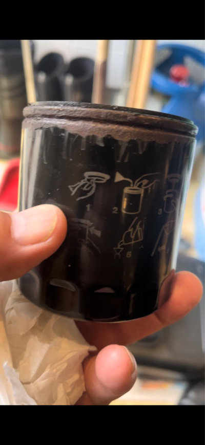

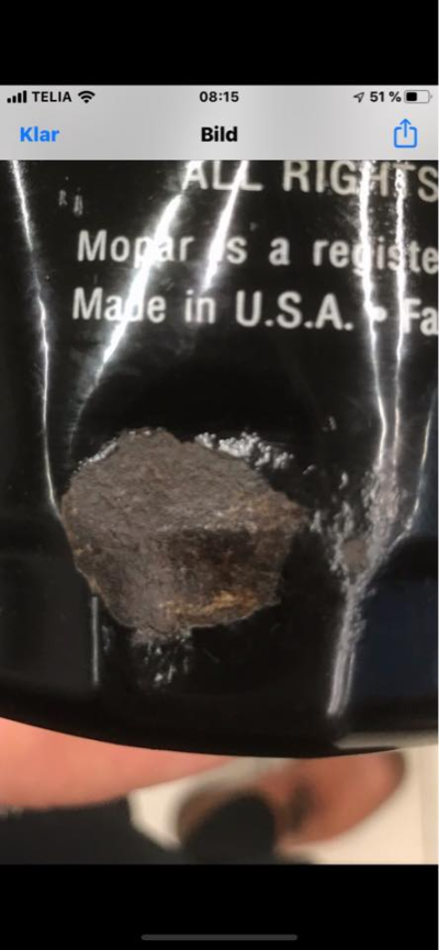

from a Swedish group where the owner says he have this problem for the second time, rusting true the filter :O 5.000miles on the filter sitting on a 2018 RAM 1500
Is this something you have seen before?

Many, many years ago we were running Hastings filters on our company trucks, and the paint would flake, and they would get some fairly minor surface rust. Nothing at all like your photo.
Is he sure he doesn't have a battery leaking acid?

Yea, but over so long time? (2 filters) First filter looked like this :O and the Dealer did not take it under warranty, said stone chips caused it and sent him a bill for $403... ( I do not now the mileage on the first one)

I get what you are saying, for sure. The example I cited above was when I lived in the northeast with heavy exposure to road salt.

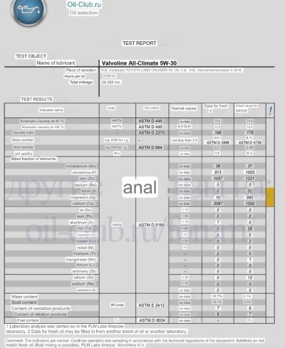

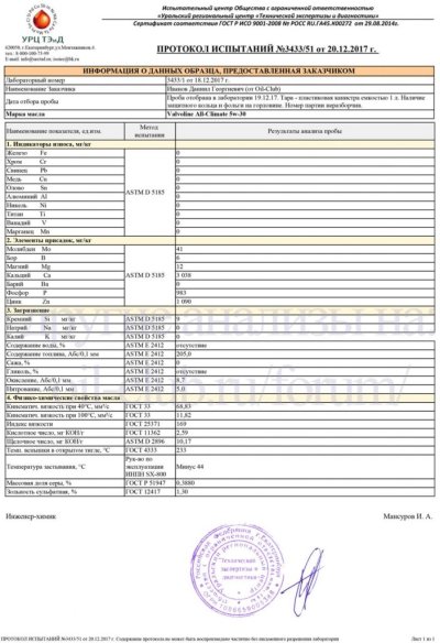

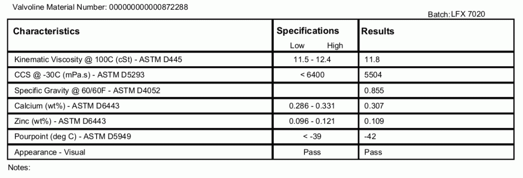

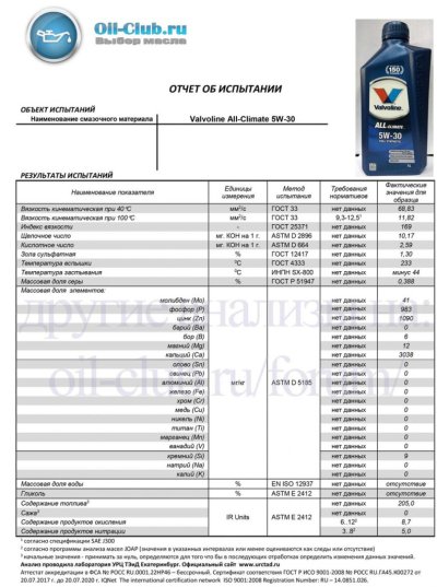

The guys on Bitog suggested that I check "oil-club.ru" for any information on Valvoline All Climate.
I managed to find a VOA in Russian.
What do you make of it?
(Translated via Google)
The oil is declared as: ACEA A3/B3, A3/B4; API: SL/CF; GM-LL-A-025, GM LL-B-025; MB-229.3; Renault RN0700/0710; VW 50200/50500; Recommended for use where Fiat specification 9.55535.G1 is specified.
1) The oil meets the SAE viscosity standard and can be called 5W-30.
2) Viscosity at 100C = 11.82 - as expected in ACEA A3/B4 oils in which HTHS>3.5 must be maintained. As always, Valvoline mixed base oils in exact proportions. I praise you.
3) Alkaline number = 10.17 - a very high alkaline number, hence the good washing and neutralizing properties of the oil.
4) Acid number = 2.59 - the norm for full ash.
5) Sulfate ash content = 1.30 - ACEA A3/B4-2010 standard implies ash content up to 1.6. In principle, the ash content is not the lowest, but for this calcium sulfonate additive package it is the minimum possible. In general, everything is fine for this oil.
6) Flash point = 233C - this is where we need to praise, the flash is higher than the “hospital average” among such oils. Most likely, the CCS of this oil is somewhere around 5500-6000 (while I was writing I remembered about the passport that I posted, it really is 5500). Why is this good? The oil is made (as much as possible within the standard) with a slightly higher content of thick 6cst base oil. And this will have a beneficial effect on NOACK , and on the flash, and on HTHS. In general, the oil is thermally stable at high temperatures.
7) Pour point -44C - everything is fine, you can safely use it in cold weather. Up to -30C sometimes with a slight excess. At least you won’t be left with a frozen crankcase - there is a reserve.
8) Sulfur content = 0.388 - average, also the minimum possible for this package of additives and hydrocracking oil. An additive package based on calcium sulfonates is immediately visible by the sulfur content.
9) Judging by the elements, the Infineum additive package is used here, as I dare say, the latest version - improved with organic molybdenum, which reduces fuel consumption, slightly increases efficiency, additionally resists wear, and reduces friction.
10) Anti-wear additives - phosphorus and zinc, in abundance. Calcium-based detergent/neutralizing additives.
Conclusion: Stable oil from Valvoline in every sense, both in terms of parameters and properties. Perfect for cars from the 90s and 2000s, as well as versions of cars without modern bells and whistles from 2010-2017. Perfect for areas in the European part of Russia. It should be stable in terms of fumes. There are no obvious disadvantages. "

From what I can decipher of Russian, that looks pretty good to me. I like the viscosity on the higher end of the 30wt scale...

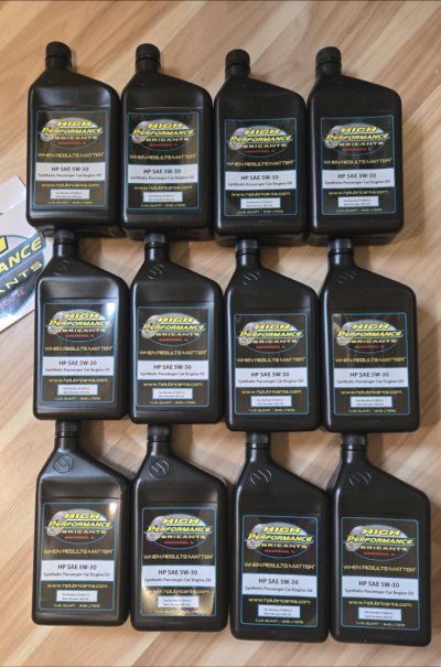

Since I couldn’t find Redline 5W-30 out in the wild I was able to get some PUP 5W30 thrown into the Rebel. So far it runs great and the added bonus of about 1 mpg increase.
Admittedly this truck never had a true “Hemi tick” so Redline wasn’t much more than an pricey “peace of mind” maintenance item than anything alongside the larger oil filter. If all goes well I might just stick with PUP for now

If you want even more peace of mind, then I would suggest adding some Lubegard Biotech to PUP every other oil change or change the oil every 3 - 4k miles. Gathering from what I've read and learned so far, short OCIs are the best preventative.
Also I would suggest trying PUP 0w40 SRT.

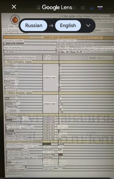

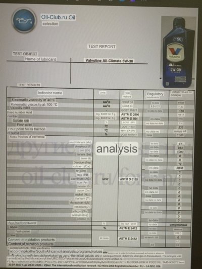

I took some pictures of the Russian stuff.. even a UOA using the Google Translate app on my phone. IMG_8147.jpeg
Reading through translated threads of Oil-Club.ru, it appears the word in the middle of the last pic is very accurate.
BITOG isn’t so detailed in their discussions to even talk about the additive & base manufacturers. It’s the sort of place Lakespeed Jr will call Heaven.
And they’re not too big on moly for some reason.

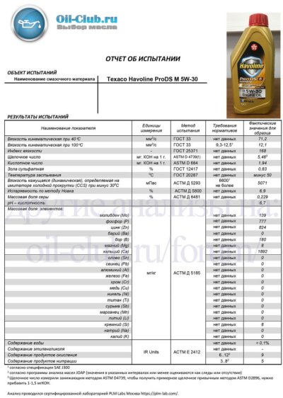

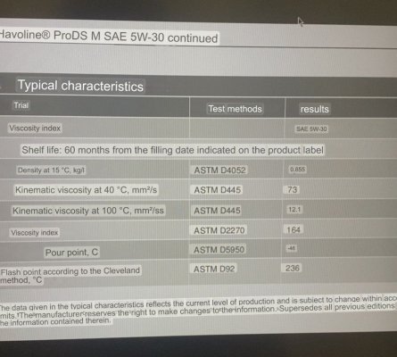

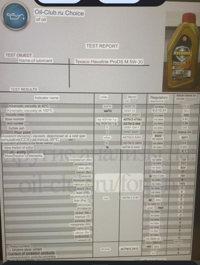

I decided to check out the Russian oil site for another oil that doesn't get much press or mention - on here or BITOG
Havoline Pro DS 5w30
Outside of the US, it is called Texaco or Caltex, however I believe all the formulations are the same.
This is what found.
Report Translated via Google
"The oil is declared as: API SN; ACEA C2/C3; MB 229.51; MB 229.52 ; GM Dexos2; BMW LL-04; GM-LL-A-025; GM-LL-B-025.
1) The oil fully meets the SAE standard for both viscosity and CCS . This is 5W-30 - as stated.
2) Viscosity at 40C = 71.2 - like all ACEA C3, a little thick...
3) Viscosity at 100C = 12.1 - HTHS >= 3.5 should withstand. Also thick, less economical, more viscosity protection.
4) Base number = 5.46 - measured by the laboratory using the ASTM D 4739 method, it slightly underestimates the base number compared to the usual ASTM D 2896, if measured by this method, it would be about 7. This means that the oil has average cleaning/neutralizing properties . (the alkaline cannot be raised higher, since the ash content is limited by the standard, in order to save soot and catalysts).
5) Acid number = 1.94 - normal.
6) Sulfate ash = 0.83 - normal. Of course, it exceeds the ACEA C3 standard by 0.03, but no method will provide such accuracy, and such accuracy is not needed. The ACEA C3 standard limits ash content to 0.8.
7) Pour point -50C - of course, an outstanding pour point for hydrocracking, but I think it is a little underestimated. In reality, even if the oil is -45C, we can assume that the oil has excellent low-temperature characteristics. ACEA C3 oils typically have -40C -42C. And here it turns out with a large margin.
8) The viscosity of simulated cold cranking with a starter at -30C = 5071 - meets the requirements of the SAE J300 standard where 5W-30 should be no more than 6600. Normal, standard starting in cold temperatures down to -30C is guaranteed.
9) Volatility according to the NOACK method (waste) = 6.9 - a record for hydrocracking, so low that it seems underestimated by the determination method. But even if it’s not 6.9% but 9%, it’s still excellent. The oil is thermally stable at high temperatures and should be very reluctant to burn out in the engine.
10) pH acidity 6.7 is normal for medium ash.
11) Sulfur content = 0.229 - There is not much sulfur here. The base oils are pure sulfur, the rest is from the additive package.
12) Based on the elements of the additive package, it is difficult to say with certainty who the manufacturer is (there are few such oils that have come across), but most likely it is Chevron Oronite (although there is a possibility that it is Infineum.)
13) The oil has a rare feature for ACEA C3 - it contains organic molybdenum. It will provide additional fuel economy, wear protection, and anti-oxidation properties. Perhaps it will work more quietly.
