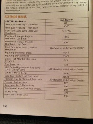

Because I'm lazy and don't want to research for it, what bulb is needed for the LED tail light on my 2014 RAM? Driving home from work today when I turned on my left blinker I got the ding and message indicator letting me know I had a bulb out.

Today while driving the message of left turn signal out was still showing, but at one point the message cleared and left worked normally. A few minutes later it popped back on. When I got home pulled the left rear housing out, disconnected the power connector checking the pins for damage. Pins looked good so I reconnected power and tested and blinker work without error. Guess maybe there was something loose or misaligned.
Time will tell.
