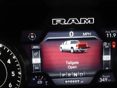

U get a picture in the EVIC of an Open Tailgate and says: not 100% on verbage, Tailgate open
Also, the Picture of the vehicle in your evic near top will show a darkened symbol for tailgate open, same light that shows doors open, hood open, etc...

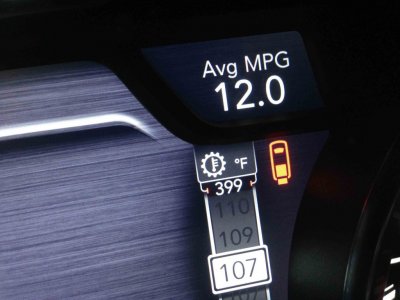

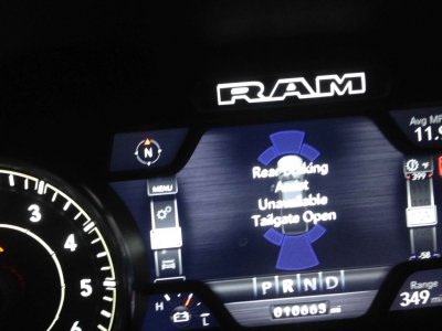

I'll go outside and recreate and show U EVIC if not too hot, LMAO.
WHAT I THINK U should see, as since U have a Laramie and a lot higher trim than my Bighorn. Items shown from EVIC display on a MY 19 Bighorn, 5.7, non-etorque.
Pics: Door Open Light, Tailgate Open Light, Tailgate Msg, EVIC Display Tailgate Open
door open light.JPG tailgate light open.JPG Warning msg.JPG Tailgate evic msg.JPG

Wow thanks I definitely am not getting any tailgate messages but I do see the door.
