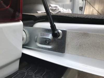

Mine hasn’t broken yet, but I decided not to wait till it did. I ordered one from Amazon and it was the old version, I tried to return it and they said keep it and we’ll refund your money, so I have a spare old version now. I then ordered one from Advance Auto Parts with a 25% off code and free shipping final price $27.88 with tax which is about the same as Amazon. This one actually came from DeeZee and luckily it was the new version.
Today I removed the old tailgate setup and installed the updated version, fortunately the nutsert wasn’t damaged yet.
That looks MUCH more sturdy...

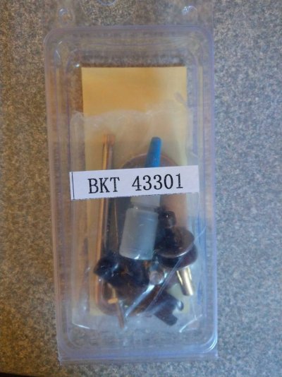

@JB1 which part number did you order, they have two listed, I wonder if one is the old version and one is the new version?
Edit - DOH nevermind only the 43301 is for the RAM :).
This is how the old one comes labeled...31ae8c232b0c6d32f0c4257a3955f2f2.jpg
Both packages were identical by looks and number, only difference was the contents
I hate it when they do that...
