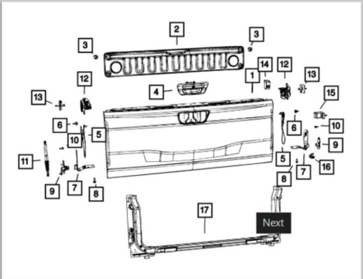

My tailgate latch won’t release on one side. I took the cover off to flip the manual releases switch and that broke off as well. Now I have no way to even drop the tailgate to replace the latch. Without that release switch how am I supposed to get it dropped so I can replace the parts?

There is a cable or rod (called link in picture below) that runs from the center tailgate release handle to each the locking tab. Use a pair of pliers and GENTLY pull on that cable while pushing the tailgate a bit towards the front of the vehicle. you may have to disconnect the rod from the handle itself. Lock tab should release.
This is a Chev, but Ram are similar
Ram 3500 Picture

Gain access from inside the tailgate, once you remove the cover you should find a couple of long rods that go from the center of the gate to the latches.
Tug the rods towards the center , and that should release the latch.

Does your truck have a mechanical or an electronic latch release mechanism?
In the following video, the tailgate uses electronic latch releases, no rods.
This link to a one-timer poster's reference to releasing the tailgate with a small screwdriver looks interesting.
