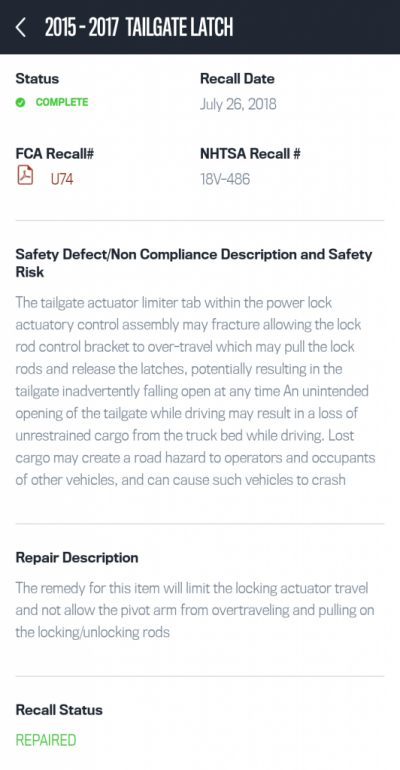

My 2017 had a recal for tailgate latch. Has yours been done?
The Mopar app will have your trucks info.

What causes the tailgate to "open" itself is when the tailgate is power locked. The actuator pushes in part of the latch mechanism, the recall installs a part to limit the actuator travel.
