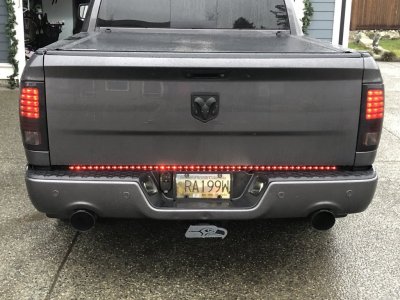

If your running the OPT7 tailgate led on a newer Ford, 8t My very well trigger the system for towing errors. There is a module you can get from OPT7 that will fix that. On Amazon

Was just looking at doing the OPT7 triple they also told me I needed the module for the backup camera.Which length are you guys running 48" or 60"?

I got the 60" as well...fit perfectly. I didn't use the module on my 2013 but you may need it if you have back up sensors or anything like that.

Just installed my opt 7 60” light bar on my 19 classic with sensors and back up camera.
removed the spare tire grommet, used curt adapter, used the 4 clamps that came with light and some gorilla double sided tape on the ends of bar, connected white reverse wire to a bullet adapter and plugged into the 5th hole in the curt adapter. Zip tied wiring to undercarriage of my truck.
light works like a charm and the reverse light is bright
