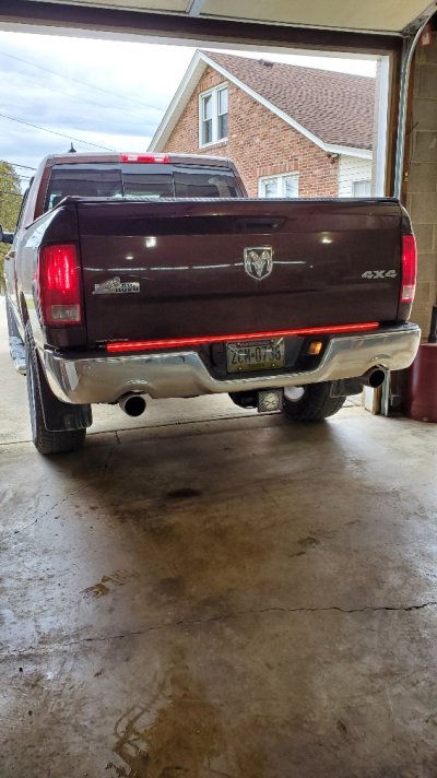

Got it installed today! I used the 5 pin Curt T- Harness and it was a piece of cake!16e0b73f2a462bdc09c082fb9323588a.jpg

Yep, same thing I did. Saw a member on here do it so why reinvent the wheel!!!
Plug n play easy!!
