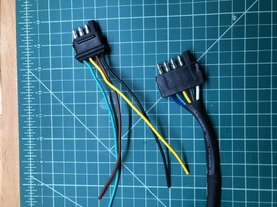

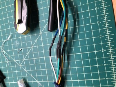

I purchased the Putco Redblade tailgate lightbar, which came with a flat, four pin connector and a loose wire for tapping reverse lights.
I cut off the 4pin connector re-wrapped the harness to include the reverse wire and soldered a flat, 5 pin connector to the "new" tailgate led harness.
I used the Curt 5pin trailer t-harness and plugged everything together.

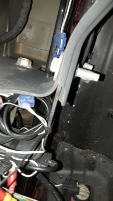

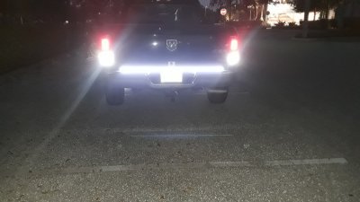

I did this same light bar. It's been on the truck for close to 2 years. Attached it with magnets. As you can see, it clears the hole for the spare, no need to cut the grommet. In reverse ut puts out a decent amount of light. I went thru the wires on the back, even though it comes with the plug for the hitch, but I wanted the plug free. So far, no interference with trailer hitch.20191113_061715.jpg 20191113_061722.jpg 20191113_061457.jpg 20191113_061644.jpg 20191113_061457.jpg 20191113_061543.jpg

Won't let me load the video of the turn signal/hazard lights, but they are very visible.
