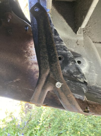

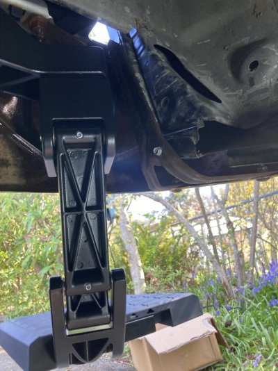

Just installed a bed step myself. Seems pretty sturdy and installation was a breeze. Yes, you have to remove a corner bracket from the bumper, but you can re-fit it with a small modification. I just made a bend in the original bracket and reattached it by drilling a small hole and using a self-tapping screw.
