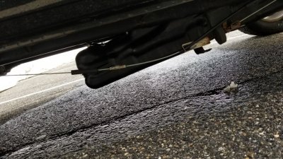

On my 2015, this happened this past Saturday. Used a ratchet strap to secure the tank. Went to the local Ram dealer, and they are getting me in Monday to fix the bracket. It's technically not a "recall". FCA just extended the warranty to 12 years on the bracket. Attached is the letter from FCA.

I was just informed that the extended warranty is only good in Canada.
I just had the ones on my 14 Ram in December and I'm just west of Chicago. They didn't give me a hard time getting it in, just took them 4 days to do the couple hour job. I gave them the first day then I called the other 3 days and got "hoping to have it done this afternoon" I got no answers back otherwise. Not a fan of the service department there, that is not the only issue we've had with them. Had to get the regional involved one time.
My guess is they sat on it, doubt anyone would still be working there if a few hour job like that took them days.
Daw14
Nov 29, 2017
3,416
5,451
South Florida
If your dealer gave you that info it is probably time to find a more informed one , what else are they wrongly claiming ? This was not going to earn them much money so that could be a reason.
Either way I would find a different to do the job.
