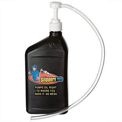

Nah fellas, just look up slippery pete pumps, they are under ten bucks and go on either quart or gallon jugs.
