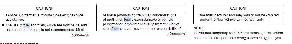

Be careful on additives. RAM specifically says no way Jose. Read yer manual. Use at your own risk/discression. Attached from your manual, which if you do not have, you should download:

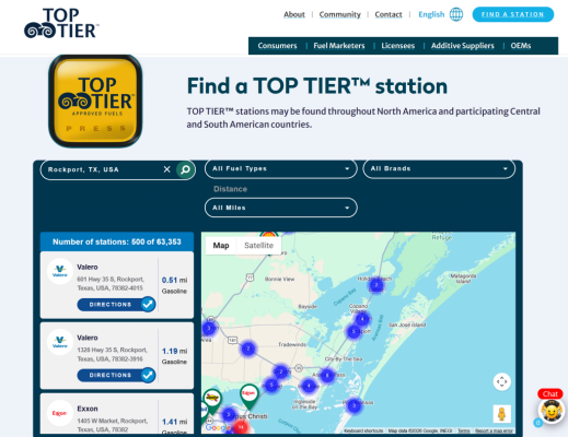

If you are still located in Rockport, Texas, the web site toptiergas.com is showing seven options in your area and within 3 miles of zip code 78381 for TopTier gas, and a whole lot more within 10 miles. I had to guess at your zip code but check this site out to find stations closest to you.
https://www.toptiergas.com/#stationsScreenshot 2026-02-26 103740.png
https://www.toptiergas.com/#stationsView attachment 580502
This issue I have with this site is it lists BP and BP is no longer top tier. So make sure you double check the stations it lists.
Interesting. How do you know?
EDIT: Never mind, I just saw it.
The BP gas stations in my area have new stickers on the pumps stating they are rated a Top Tier fuel.

LOL...
"BP is generally not listed as a Top Tier certified gasoline brand, as it was removed from the official Top Tier list in late 2021. Although BP states their fuels with Invigorate® meet or exceed Top Tier standards, they are no longer part of the official licensing program, often speculated to be a cost-saving move."
https://www.google.com/search?q=is+...4B4IDwgcFMC41LjHIBw2ACAA&sclient=gws-wiz-serp
AND...
Yes, BP and Amoco gasoline in the US are Top Tier certified in 2026. All grades of BP and Amoco gasolines with Invigorate® additives meet or exceed the Top Tier detergent requirements for engine cleanliness. [1, 2]
Top Tier Status: As of early 2026, BP/Amoco products are included in the Top Tier licensed brands list."
https://www.google.com/search?q=is+...AuMbgHZcIHAzItMsgHBoAIAA&sclient=gws-wiz-serp

If I am wrong, I apologize, I was to the understanding that they dropped out of the TT program.
Curmudgeon
Jul 22, 2017
1,541
4,712
York, Pennsylvania
2014 1500 Laramie 4x4 QC, 3.21 rear, 8-speed
They "were". Post #15 explains it.
They are back in for 2026.
TT is merely a resource, not Gospel. Trust but verify. ;)
