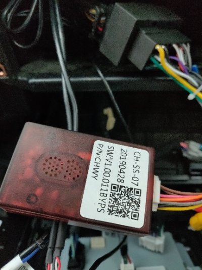

Your CAN and AIR Baudrates are correct. Dodge Ram LO is for the 4-fan speed with that large black plug. (Your truck)
If Changyuantong with Bagu doesn't work, try Changyuantong with Xinpu. It's the Protocol our Linkswell Radios use.
That red CANBOX with the CH-... serial number (in our case) is usually for CHEVY vehicles. Our Dodge Ram red box starts with XSBOX-007. Maybe you have the wrong CANBOX? Running a Dodge Ram XFY, SIMPLE, or CANBUS update may fix that. (If you can find one)

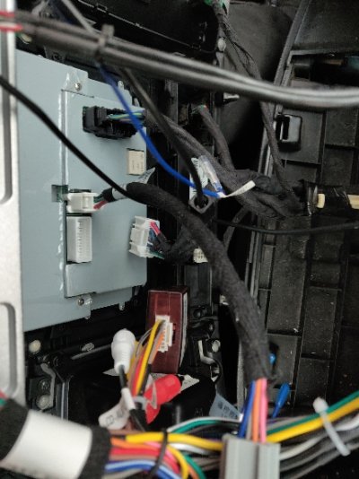

Did you buy your radio from Rhino?. I saw your harness/CAN pics and noticed these are exactly the same as the ones they came with the radio I bought from them last year. I also have the 4 speed fan RAM truck and had the same issue with the AC not working at all or when it decided to work, air just blew through the windshield. The problem is a combination of incompatible CAN / harness with the 4 speed fan truck. There is no software fix for it - I tried every possible solution and they even sent a replacement unit which basically fried after I installed it and Rhino sent me a full refund. Best advice return the radio.
While Phoenix customer service sucks, I was lucky and ordered a cheap refurbished unit. Before I ordered the unit, I clearly told them about my truck been the one with the 4 speed fan. When my unit arrived, I noticed their harness and canbus came labeled RAM Lo different from the ones from both radios I had from Rhino. I been with this refurb unit over a year now with no issues and everything worked after installing it.
I found the pics I took from the Rhino's CAN and harness below.
