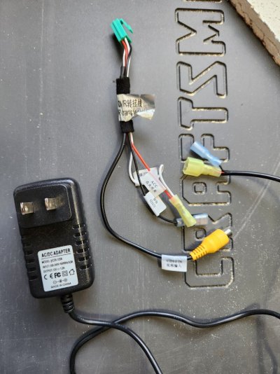

Hi, I was unable to read the diagram well enough to trust it. Thanks though. If you remember your actual set up, that would be great.
Here you go...I used an old power supply for power.

Does the truck have a backup camera?
If not, I would suggest heading to a salvage yard and there you should be able to find an original backup camera for the tailgate.
After that just get the unit linked in this post.
There might be newer ones posted as well. So you should do a search and make sure to select one with a minimum of 4GB ram 64GB memory and Apple Carplay.
This should help as well.
He has the camera but he has to switch to it thru the menu. It doesn't automatically activate when putting the truck in reverse.
It should, provided the connections are done correctly. Otherwise I would say that it is a failed unit and should go back to the seller for warranty
