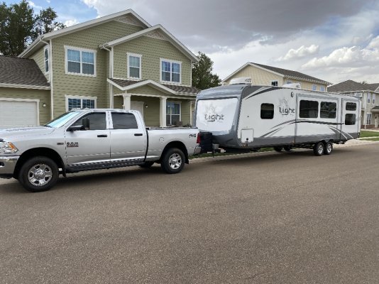

Here you have a 8200# empty, 9600# loaded trailer. Empty my tongue weight is 1000#, full my tongue weight is 1380#.
This is why I bought a 2500 with the 6.4. So I could have 3690#s of payload.
3690-1380=2310.
It’s called Margin, and you need more than what you carry.
So yeah running down the road with a fully loaded truck at 70+ is stupid, yeah that Hemi will get it up to speed, wait to you need to do an emergency stop and the trailer jackknifes on you and either kills you and your family or god forbid someone else.

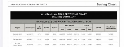

What trim level do you have to get 3600# payload? My 2020 6.4/ZF has 3100#. Is the 6-speed that much lighter?
I have a tradesman! LoL hardly any options. All I got was the motor, trans and the 4.10 gears I wanted.

The 2020 lost 200lbs.
@AFMoulton are you The guy who had the snow chief package with the higher rated front axle that I discussed with before.
My tradesman doesnt even have the shark fin. I do have the long bed...which drops some payload over the short bed...but mine is only 2998 only options on mine are tow mirrors and protection group
I had this discussion with someone and that was the case.
The 2020 the longbed finally has more payload than the short bed.
3600lb payload is 3500 territory for a SRW.
But I think that is what we discovered the snow chief gets a higher rated front axle

2018 Payload ratings look to be less than the 2020 models by 50 pounds for crew cab Tradesman 4x4 6’4” bed models.
My 2020 2500 Tradesman 6.4/ZF 4x4 with the off-road and Snow Chief packages has a 3146# payload. These packages add 204# to the truck resulting in a lower payload.

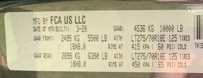

@Sandevino the 2019/20 save about 200lbs over the 2018.
I see your truck has the same front axle as mine. But your rear has 390 more lbs of capacity than mine.
Mine is 5500 front and 6000 rear.
That is interesting
