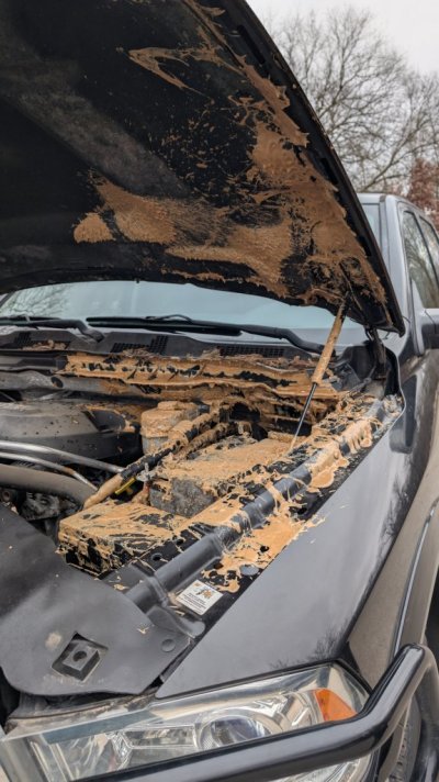

Sick to my stomach. My Engine just blew. 2016 with 96,000 miles. 6.4L, Laramie. Needs a new engine and entire cooling system. Estimate is $18,000+. I'm retired and can't afford that. Also can't afford to lose the truck.
"Blew" how?

Coolant hose blew off the radiator, OAT and engine oil everywhere - like a slasher film. Engine block cracked or head gasket? They don't know yet due to all the fluids. No warnings, no overheat, gauges all looked good - oil temp, trans temp, oil pressure, coolant temp, everything.
View attachment 560094 View attachment 560095
Yeah, that is nasty. You could save a bit with a independent shop putting in a salvage pull.
That sucks for sure! Ive been feeling good about my ‘16 6.4 with 115k on and never had any issues at all with the motor (or anything else for that matter), but this certainly makes me cringe. I take it you didnt opt for the lifetime warranty?
I wasn't offered a lifetime, I grabbed the "Platinum Plus" for 84 months or 100,000 miles. I'm okay on the miles, but over the time limit. I hadn't had any problems at all either - until it went p.o.o.f !
I have a car on order to replace my - ahem - Prius with over 200,000 miles. I guess fixing the truck means I'm stuck with that beast. I just have a hard time spending 18k (that I really can't afford) and then I'll worry the tranny or something else will go next. But I can't just dump a $60,000 truck either. Decisions decisions...
